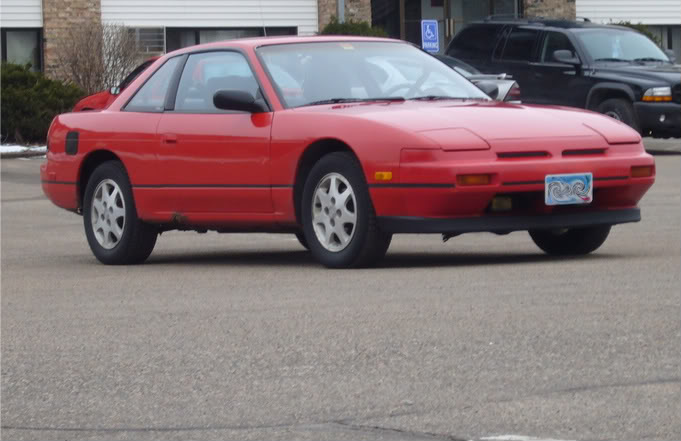

How pretty my S13 looks after the wash. I almost forgot it could look this good. I kind of feel bad using it as a winter beater.
