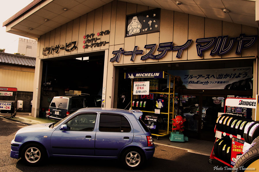

When I first moved to Japan, the apartment I lived in was close to a local maintenance shop. They usually speciallize in tires and oil changes, but they also do custom car audio/media installations, minor mechanical work and sales and service of selected aftermarket parts. Think of it as a smaller and local Autobacs.
The owners have always been good to me. They are friendly and outgoing and very hard working and are very comitted to making sure their customers are happy and satisfied. Not only that, but they are also automotive enthusiasts as well as avid motorcyclists.
Anyway, they are good at their job and they enjoy the work that they do, so it’s a win/win situation. I love being there and just hanging out, plus the soda machine has Mt. Dew!!!

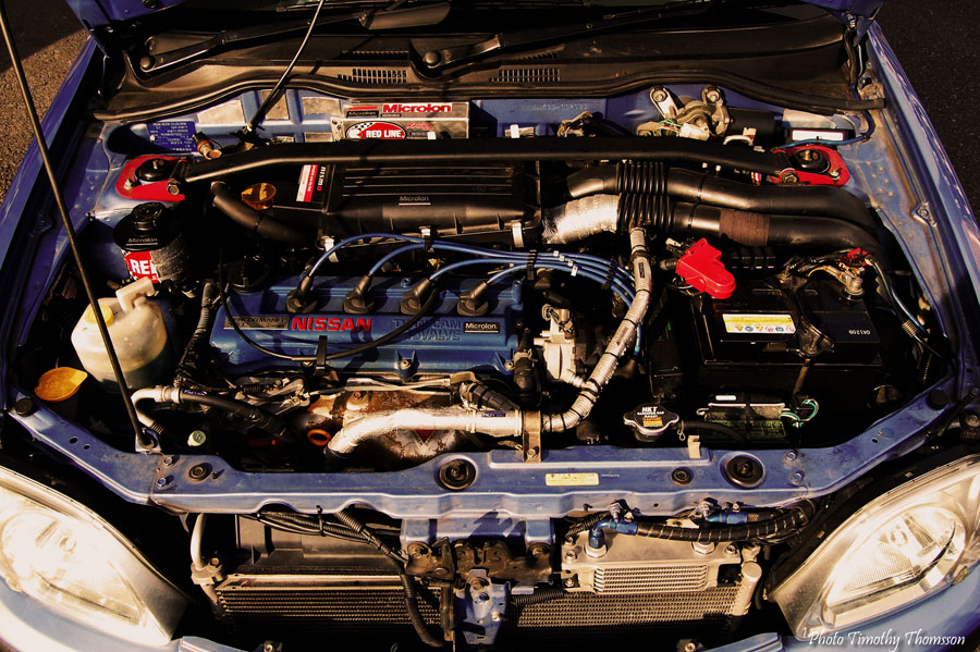

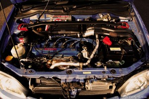

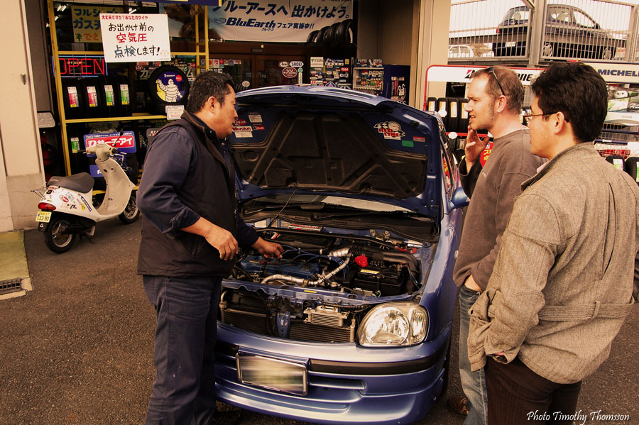

Engine/Exhaust/ECUI:
1300cc GC13DE twin cam inline 4 cylinder
NGK Iridium plugs
Nissan Cube Alpha intake cam
Nissan Cube Alpha exhaust manifold port matched to cylinder head
Standard throtle body bored 2mm over stock
Standard intake minifold with port matched plennum runners
Surge tank added to intake manifold
Air intake modified from single runner tube to twin runner tubes
Cat flange port matched to exhaust manifold flange
B-pipe modified to remove crimped section at stabilizer

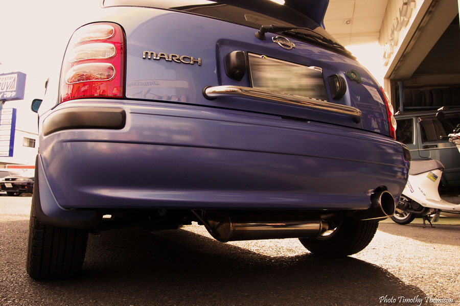

Nissan Cube Fujitsubo cat back exhaust modified to fit K11C March
ECU re-flashed to remove speed cut. Over 180km/h possible

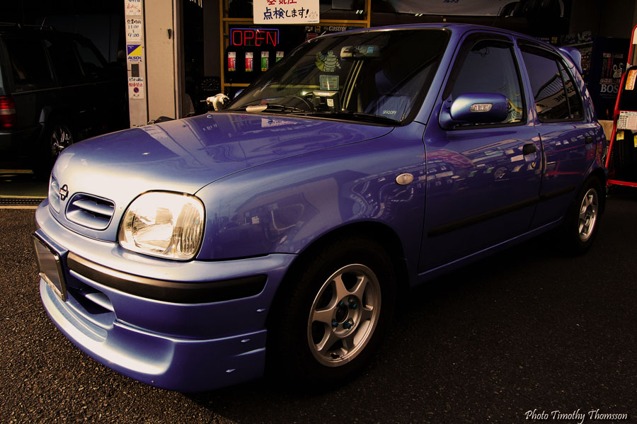

Suspension/Brakes/Wheels:
Standard suspension and brakes
Hayashi Racing 14X6J wheels
Michelin 165/65/14 tires
Nismo front body brace
Interior:
Nardi steering wheel
Modified WC34 Stagea wiper stalk with intermitent front/rear wipers
Pioneer head unit that is MP3 capable
Normal speakers with molding clay backing to increase sound performance
Custom sound deadening for floor/roof/door pannels
Recarro LX front seats with custom Snoopy seat covers
Exterior:
Nismo rear hatch spoiler
Nissan Y50 Fuga mirror signal lamps modified to fit standard K11C March mirrors
Custom “vortex generators” to help with aerodynamics
