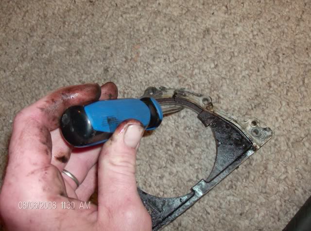

I tried to use my seal pick set to remove the seal from the retainer and bent them all, so i had to drive the seal out of the retainer from the back side of it with a flathead screwdriver by sticking the head in the groove of the seal and striking the screwdriver with a hammer.

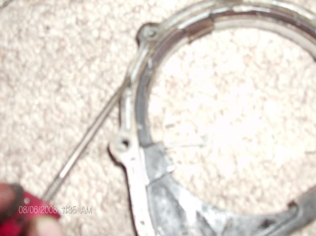

Next take the putty knife and scrape all the old gasket material from the block and seal retainer. The seal pick set worked real nice to get the gasket material out of the grooves on the retainer.

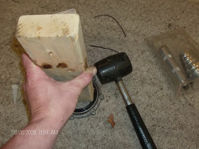

Next you will need to install the seal in the retainer. I bought a seal driver set, and the driver heads were too small for the size of the seal, so a CLEAN cut 2×4 had to work.When installing the seal be sure to put the grooved side with the cord facing downward.get the seal pused in by hane as far as you can before using the mallet and 2×4.Strike the seal untill it seats in the retainer.
